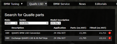

What if I just do the change without retaining the open diff so just sell it with the LSD, how much am I looking at to have a Quaife LSD fitted to my car, and is it the Quaife ABT LSD that I want, for example the link below, I’ve seen them approx £1,200-£1,500 thn I’d just have to pay what it costs to have fitted right?
So you send them your diff its £1,711 + vat ie £2050
If you want a diff with uprated bearings its £2,500 ish exchange
I bought a used 35is diff (remember 35i manual and 35is different ratios) for £350 sent it to them ..they did the work ie £2,050 I was £2,400 in the hole..5 years later sold my old diff for £350 to a guy doing the same trick..
View attachment 292502View attachment 292502
Thank you for the info, to confirm this is for retaining the current diff, and Quaife are solely doing the work to convert it to their LSD, they’re not fitting that to the car?
