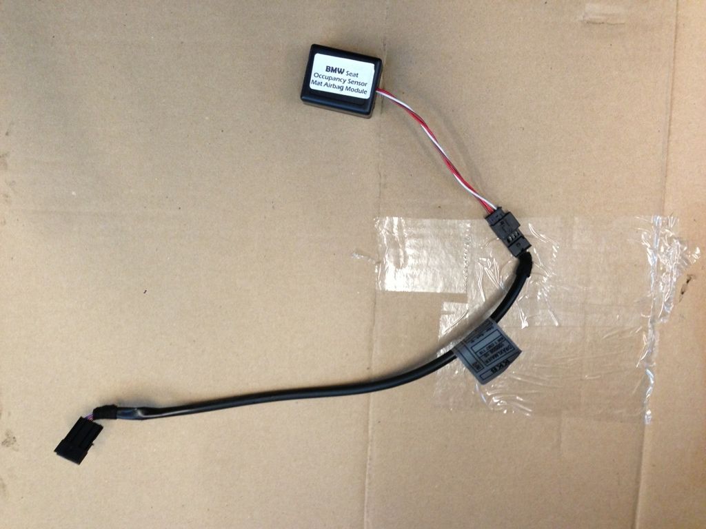

I'm ready to install my 2nd race seat and only reason I've held off till now is due to the dreaded airbag light that would result after disconnecting the occupancy sensor. The only workaround is to purchase a new mat sensor which costs approximately $500usd. Instead I'm going to try one of those eBay emulators which tricks the car into thinking someone is in the seat. Has anyone tried this yet?

Just want to report, the bypass module from eBay works! After removing the stock seat, I made sure to disconnect the battery for about 30 mins. Unplugged harness below the seat, transferred over the occupancy wire along other cables. Plugged in the module, installed my race seat. Turn key, NO airbag light =)
Oh yea, 2 things to keep in mind though:
1. With this bypass, the car assumes someone is always riding in the passenger side. That means should you be involved in an incident even with nobody riding beside you, the passenger side airbag should/will deploy.
2. Because the car assumes someone is occupying the seat, you will get the seatbelt chime on. Seller provides 2 workarounds, one involves opening up the receptacle. The other is to keep the belt always plugged in. I actually purchased a separate seatbelt extender to use with my Recaro so something's always plugged in.
