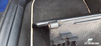

My glovebox "fell" off one of its hinges the other day. While fixing it I realised that there was a design change at some point such that the later gloveboxes do not simply pull off the hinges like in the pelican parts guide.
Instead, the pivot "dowels" of the hinge can be moved in or out to slot into the glovebox lid.
Here is a photo of mine with one dowel pushed in and one out:
I managed to put the glovebox in place and use a small screwdriver to push the dowel into the hinge.
I.e. if you wanted to remove the glovebox, don't pull on it or you would snap the dowels. You need to fully remove the outer plastic glovebox housing then push the dowels in from behind.
Glovebox lid hinge :
