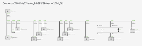

The topology for the Kbus comb can be found here: https://bmwteka.com/wds/en/e85/c34fc6f5
Some observations:
1.The schematic shows the run to the SIM, KOMBI and Radio / Entertainment to be a thicker gauge wire. Might be useful for anyone de-pinning the Kbus comb.
2. You can disconnect both the Kombi and Light module by removing the single screw holding the Kombi in place and reaching through to the LM connector.
3. The middle connector of the GM5 carries the Kbus. From memory it was Pin9
4. If you suspect your Kbus run to the SIM or other longer runs you can use pin9 from the GM5 or the comb to test resistance on the Kbus line to the SIM connector. Usual battery cautions apply.
5. You can remove the lower cover below the steering wheel with a single screw. You can then disconnect the Kbus connector for the clock spring easily if you want to kick it off the bus to test.
