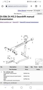

I had my gear Shifter overhauled with new OEM bushes, plastic insert and brass knuckle {numbers 2, 5,7,and 12) and it made a notable improvement :driving:
Did you do this with the transmission still in the car or does it need removing to get access?
in situ, needs to be lowered a bit to get access to brass knuckle. Think I paid about £280 labour and about £90 in parts a few years back.
