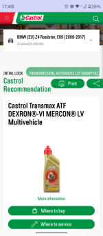

Just use the official Castrol Site they explain exactly what is recommended - Transmax or Syntrax etc, grades and quantities by Registration :
https://www.castrol.com/en_gb/united-kingdom/home/car-engine-oil-and-fluids/motor-oil-and-fluids-finder.html?customerType=retail
No mention of manual transmission oil req.
