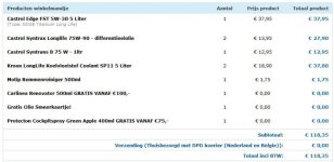

I LOVE freebies!! :lol:
OK, It's only a can of cockpitspray that probably smells like catp!ss and a bottle of paint renovator that probably does more damage than good. But 100 quid for that little lot is a tidy little price. :thumbsup:
Ach s**t! I've fkd up there - I've ordered 2L of diff oil when I shouldve ordered 2L gearbox oil.
What a plonka! drrr.
