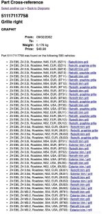

mmm-five Lifer Liverpool Jan 13, 2025 #2 The part numbers seem to be identical for all models...the only difference being between left/right and silver/graphite options: Graphite L 51117117757 Graphite R 51117117758 Silver L 51137051957 Silver R 51137051958
