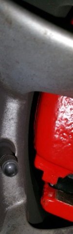

Well, i bought them, sourced some 330D brackets and painted them up. Its a tight fit in the 17" with about 3mm clearance between calliper and the wheel balancing weights....
When the weight come around they take up about half that clearance...
Nice to hear you managed to find the carriers and the installation it went well - and that you have enough clearance. The painted callipers are a nice touch (I'm thinking of painting mine blue... or yellow)
Halfords HighTemperature Engine Paint. Went on nice, I would have liked to spend more time smoothing off the calliper surface and putting down more coats (about 2 coats on there) and finishing with a high temp clearcoat, but I was struggling to get the things dry in time (had to convert the spare room into an oven ;) ). Maybe next time I'll just outsource :p
