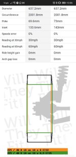

Below is a snapshot from willtheyfit.com - the orange is the 224m setup I ran, and the green is your proposed setup of 9j et 32 running same tyre profile.
I'd suggest you'll be fine - top outer edge of the tyre will be pretty much in the same place as was on my setup.
I did get some very minor rubbing but it was mostly on track rather than anything on the road...
Hi, yes I’ve been throwing all sorts of combinations into that website.
I’ve had an E85 with the B12 kit and it’s a lot firmer than Sachs with Eibach’s, I’m not 100% convinced that I might get rubbing where you don’t because of this :?
