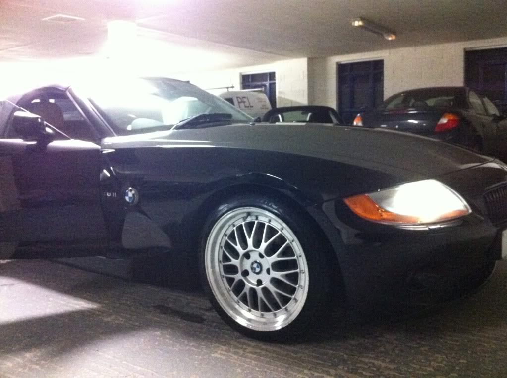

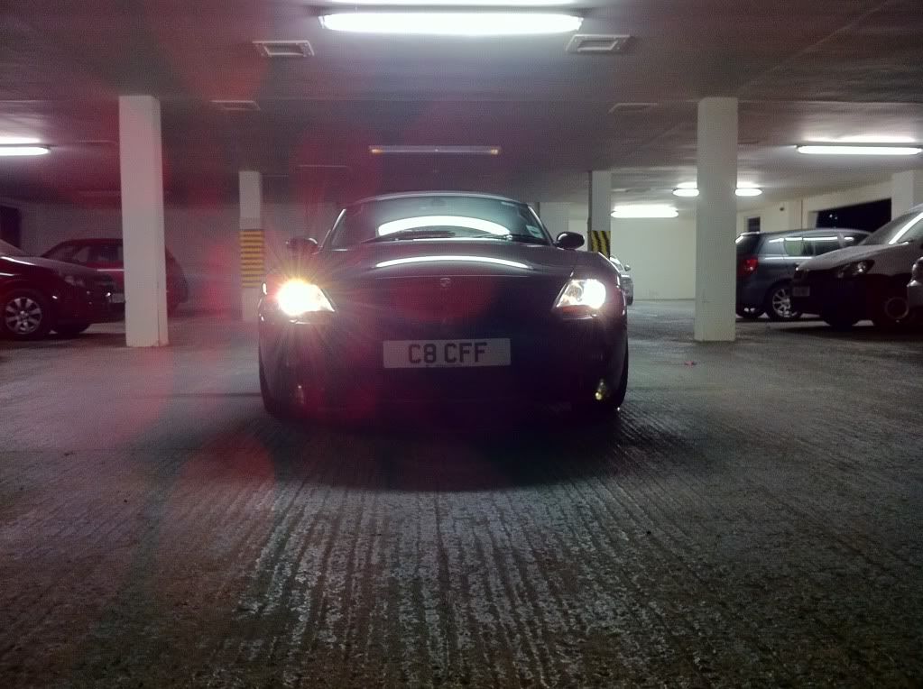

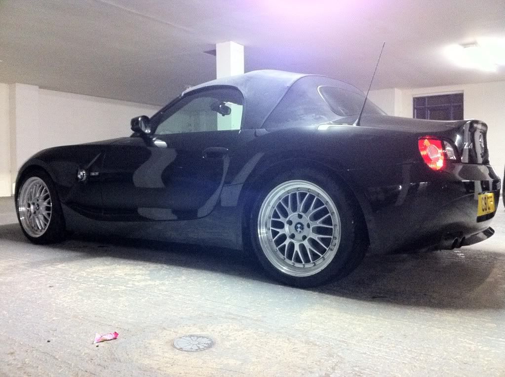

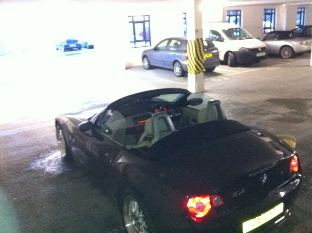

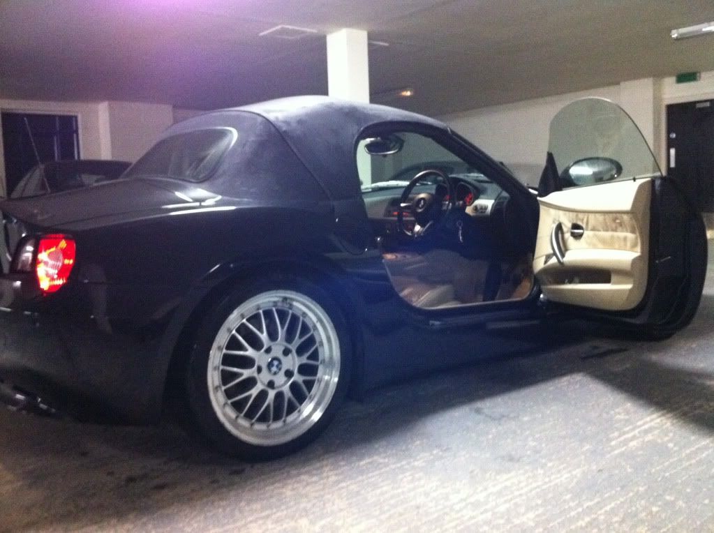

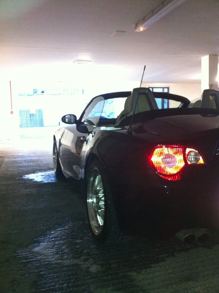

well today saw me giving the Z its first clean since coming into my ownership!
in my view the paint work was in extremely poor condition with swirls and RDS all over. Unfortunately with the light running out and what felt like almost freezing temps i didn’t take any during pictures!
Process was
Wash with 2 bucket method using a lamb’s wool mit
Then clayed the whole car, the clay bar was incredible, im unsure if the paint was ever clayed before but there were lots of contaminants! Car was then rinsed again and dried
Polishing stage was done using the 3M range
First stage was Fast Cut Plus followed by Extra Fine Compound and finally Ultrafina SE Polish. Whole car was then rinsed again and dried before apply Autoglym HD was ;-)
