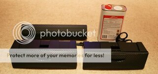

Believe it or not, I even have pictures of my first aid box online... it's hard to see from the inside, here's a picture of the top of the box, the big hole behind the latch is what CJ's referring too...
It is a bit fiddly, but like a lot of these things, do it once and it's easy thereafter.
Should be the same - when you say deeper, it's probably just the angle of the photo - the back part is shallower than the front, you can sort of see it on the right one below:
I have an original 2003 box and a second I bought new this year, both are identical.
