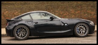

Finally took some pics with the new calipers
their where 2 types of calliper that fitted the z4m, the cp5575 and the cp5555, the cp5575 which is the one AP would ship for the z4m, is the same as the cp5555 ( sent out in the e46 m3 kit) but basically takes a pad that is 1mm thinner, 17mm vs 18mm, the cp5575/cp5555 offers no difference in external look or performance, just better wheel clearance as its basically a slightly thinner calliper , pad choice is also the same.
on the wheels i prefer the ec7, better brake clearance, looks better and the offsets are better for the z4m imo... What ever the wheel you don't want one that offers like 2mm of calliper clearance imo.... AP calls for a minimum of 4 mm between the wheel drum / or the spoke.

What brand are those rotors? They look a little different then my AP rotors?
they look like performance friction to me.
Are the PF rotors better then the AP rotors? Why would you want you fit PF rotors on your AP racing brake system?
Cheaper and better. They are completely interchangeable.
What is better with PF rotors?
Well, I think the truth is there isn't a lot in it; but the general view seems to be the PF rotors last longer; they are also cheaper and easier to get - AP hardly ever seem to have stock. Certainly when I last needed replacements I was recommended the PF (by someone who sold both).
i love the PF rear rotor as it uses a bell design so it should be lighter, the AP one piece rear rotor is heavy and could be better, come change time i will move to the PF rear, and depending on price ill add the PF ring to the AP front bell.

That looks brilliant. The blue callipers look great. Have you got any video of it on track? :D
