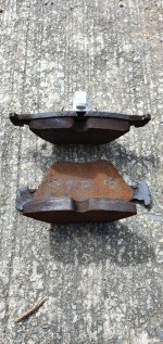

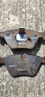

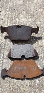

To cut a long story short I bit the bullet and got a full set of new disks and pads, all Brembo, and fitted yesterday. At the back I found one of the handbrake pull off springs was detached which might account for the strange noises, however at the front I found the "Mintex" pads with strange pitting, and one of the pads had come apart. The friction material totally detached from the back plate. These were about a year old and worn perhaps 10%. I was wondering if they could be counterfeited although they look perfectly normal.
I drove the car this morning for 10-15 mins and the problems seem to have gone away. No hard braking for the next 200 km so time will tell if the issue is really cured but it seems too much of a coincidence that the vibration has gone immediately after the change. I will contact Mintex for their comment.
