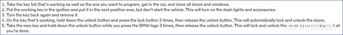

1. If I have 2 identical keys that are cut for my current ignition lock but one is NOT programmed to my car like in the image attached, will the non programmed key still start my car or will the EWS stop that key from working?
2. If I have key A that is cut for my ignition lock and I have key B that is cut for a different ignition that I am wanting to replace my current ignition with. (Both keys are programmed to the car now.) Can I just swap the ignition locks out and start using the new key without doing any programming of the EWS system?

So to start let’s clarify that key has two separate components;
- the chip that is programmed to the EWS that immobilises starting the car
- the circuit that operates the central locking that pairs with the GM5
Your instructions above are to pair your key with the central locking. It won’t ever enable you to start the car.
So to help with your questions:
1) no your non programmed key won’t start the car.
2) yes, your ignition barrel is no different to a mechanical door lock. If you swap the barrel you can use the associated key. Strange that you have two different keys programmed to an EWS though. Perhaps I’m reading your question incorrectly or mixing up programming central locking and immobiliser.

As for the two different keys, I was trying to see if my X5 key would program to my Z4 and unlock my car. It did and then I re-programmed my Z4 key by itself to see if the X5 key would still unlock my car. It did not. Then I programmed it back to my X5 again.
My understanding of the registration process was that it also deactivates keys that are not registered in the process at the same time.
So to change them out I was planning to program the present key A and the new key B (at the same time) before physically removing the current ignition from the car. Then install the new ignition and key B which is an already programmed and differently cut key.
Hope that isn't confusing.
