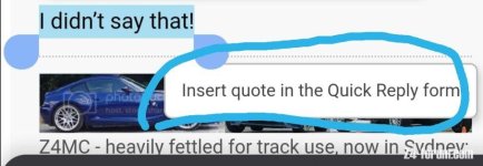

I didn’t say that!
So you didnt!
Apologies, it seems this button
Isnt working correctly and is quoting the wrong person whenever you press it :headbang:
