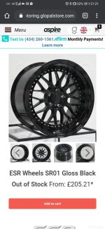

Any opinions on the following?
https://gb-aspiremotoring.glopalstore.com/collections/esr-sr01-wheels/products/esr-wheels-sr01-gloss-black
I was thinking
Front
18x9.5 et35
Possibly run 235 or 245 with a bit of a stretch.
19x10.5 et22
Running 275 and i can always bump it up if i have to
Whole thing comes to 750 which i thought was very good, and surprisingly i hear quite good things about the esr wheels

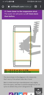

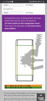

Assuming for your ZM in sig , even so those numbers are not going to enhance anything either visually or from a handling performance perspective.
10.5j et22 rears :cry: here's a previous ZM of mine with the 9j et29 224s with a 15mm spacer. I really couldn't imagine adding another 10-15mm which is what you intend..
Front would be like adding a 25mm spacer behind a 224 which will look pokey to say the least.
