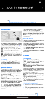

I used Millers in all our BMW cars, and my Volvo.
