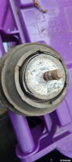

Engine mounts replaced today, you really have to jack the engine up pretty high to get the drivers side mount out, then when fitting the new ones you realise how worn the mounts are as you have to raise the engine even higher to get the new ones in.
My car idles now with no vibration at all in the cabin, defo recommend changing mounts if like me they are original and look like this.

I’ve done several recently, one was a full 1cm shorter than the new replacement part
My old mounts were about a cm shorter than the newer mounts, the drivers side mount heat plate had oil on it but the mount didn't look oily could be oil residue from when the rocker cover gasket went.
My main symptom was excessive vibration in the cabin at idle, the car now feels smother when pulling off too.
