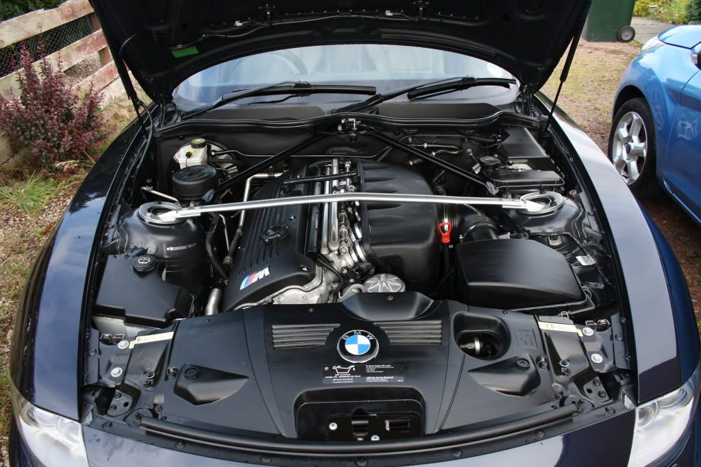

Finally finished off under the bonnet on my e90 and got some decent pics:
- hosed down with hot water using a garden sprayer
- I didn't bother protecting/waterproofing anything, the water pressure was low (wouldn't recommend a power washer...)
- Flash all-purpose cleaner (on special from Tesco :oops: ) with sponge, brush and toothbrush
- rinsed again with hot water
- paintwork AG SRP'd and waxed with Collinite #476
- plastics treated with CG trim restorer stuff
Doubt it'll ever be as clean as that again under there so thought I'd best take some photos :D
Engine bay before
(after 75k miles covered by previous owner...):
Engine bay after:
Nice effort! Personally i'd cover electrics anyway, especially the coil pack area - you don't want water down there.
Use a detailing brush with the APC - otherwise you'll be making more effort for yourself :) APC should ideally by around 1:4 ratio to water for a good clean.
I also use degreaser after the initial rinse as the engine bay WILL be full of road grime and traffic film - degreaser will cut this better.
Also, i would suggest you clean it in sections, it makes sure you've got every bit :D

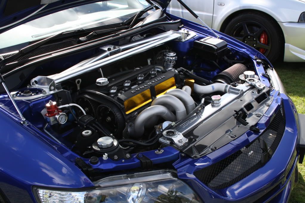

Although the engine bay was pretty clean before hand, i gave mine the usual treatment i do to engine bays when i first picked up my ZM

Do you mean around the body assemblies? I use APC as usual, taking into account the nooks. They're internally lubricated so i'm not too fussed, i do make sure i haven't got any fluids into the electrics though. I used to do this on my old Evo engine, and that scrubbed up well :)
