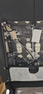

I believe you may be right, and a huge thanks for the photo, very helpful
The photo is for a seat with only side bolster airbags. I'd imagine you have a different valve setup in the top left to include the pipe for the lumber support.
So I'd say you have a leak on the pipe between the pump on the bottom left and the valve top left.
