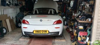

Latest visitor to Zedshed Cymru today was newish owner James with his white E89 from 2010. Its only got 7k miles on the clock and has led a sheltered life all backed up by previous MOT's. It is immaculate on top and once on the lift the underside was in fantastic condition just some very small surface rust on some of the running gear. Purpose of the visit was to apply some Lanoguard to the underside as a preventative measure. Using the supplied sray gun it was easy to apply, we started at the rear and worked our way forward on each side. Everything was given a good coating and adheared to the surfaces and got into the nooks and cranny's very well. We probably spent an hour applying it, decided not to put any on the engine bay, given the amount of dust these cars suck into the engine bay we didn't want to give it a coated surface to stick to, easy enough to keep it clean with wipe overs and some polish now and then.

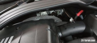

We did spot some past Mouse activity in the engine bay the insulation around the crankcase vent hose had been well nibbled at some time in the past. Probably replace it with one from Autodoc going forward for reasonable cost.

Thinking of the Lanoguard treatment…how easy is it for a DIY if you have a moderate height hoist ?
Any observations on using it vs others / none ?
Thinner than Waxoyle but using their supplied spray bottle it produces an even spray very easily. It adheres to the surfaces very well and dosn't just drip off. They reccommend letting the car stand for 8 hours after the application. Its a preety fast process to apply it as long as you get the car high enough to get under it. A lift is ideal but you could get away with trolly jack and of course Axle stands for safety. Drive on ramps are also a consideration as long as you can clrear the front bumper driving it onto the ramps, may need to put some scaffold boartd down on the approach to the ramps to ensure clearance. If you remove the wheel arch liners you would get complete coverage on the panels that hide behind them. Depending on the condition of the underside you may want to pressure wash the underside then dry before putting the Lanoguard on.

Thanks for the information..I’ll give it a go this winter…. :thumbsup:
I want to thank Colin @ Z shed Cymru for letting me use his lift to Lanoguard my Z4. The previous owner obviously looked after her, apart from not buying a cat to catch the mouse who had a good nibble of some insulation around a hose in the engine bay🤣.I feel I need to give the same if not better attention to my Z going forward.
