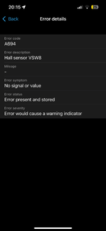

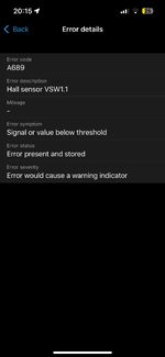

Roof was all in working order when I put it into service position to change shock absorbers and rear lights. A few hours later, the screen tells me “roof movement impaired” so I set about diagnosing without too much luck. I managed to pull some codes and with some research I believe all I have to do is replace the 2 hall sensors on the right side ram (drivers side for me as I'm RHD) and a passenger side partition clamp? - no idea what this second one is. Another thing I have theorised is my hydraulic pump has corrosion and the 3 wires going into it have some marks but actual connection seems fine (not sure what they're called) Any help or direction would be greatly appreciated as I've been banging my head for a day.

Strange for both wired hall sensors to fail at the same time
Retrace your steps you took doing the shock absorbers- have you snagged a wire or the loom?
