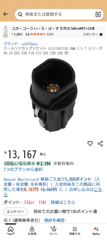

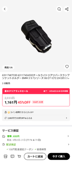

This valve socket costs 1000 yen on AliExpress, but 13000 yen for a genuine BMW part. What's the reason for this difference?Screenshot_20260817-161731.pngScreenshot_20260817-161635.png

I bought two sockets from ebay for a total of $12. I figured it's a simple bulb socket, so why not give it a shot, considering the BMW OEM sockets are $30 each.
Well, here's why not. A week later they arrive. Both bulbs are difficult to insert into the holders, and only one holder works. Jesus......
So now they go back, time is wasted, and I ordered the two I should have ordered straight away. Cheap crap simply isn't worth buying.
If you invest in a BMW, you need to be able to invest in the proper parts. If you can't, it's far easier to buy a simple, inexpensive car.
Lesson learned. Even simple plastic/metal items like a bulb socket need to be OEM.
