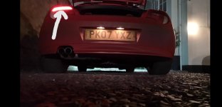

Hey all,
Probably a silly question, but for the rear lamps (not the high mounted one) on the coupe, the "bar" across the top is LED? Assume if that has gone the whole unit will need replacing? All the bulbs I can get to work fine, but that light has stopped coming on.

Yes you need to buy a whole new unit. i had the same and took ages to find a 2nd hand one on ebay.

Happened to someone else recently. https://z4-forum.com/forum/viewtopic.php?f=3&t=119727
The light unit has LED's so they shouldn't fail... interesting that both failures occurred on the O/S unit.

Any sign of water ingress? The foam gaskets have been known to fail in the past.
Left gasket: 63217167589
Right gasket: 63217167590
One of mine has water in (pretty sure its a gasket) and bulbs work fine... so doubt it will cause issues later on if left a "swimming pool" but I'm checking regularly and not driving so regularly so build-up-water/risk is minimal.
