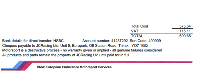

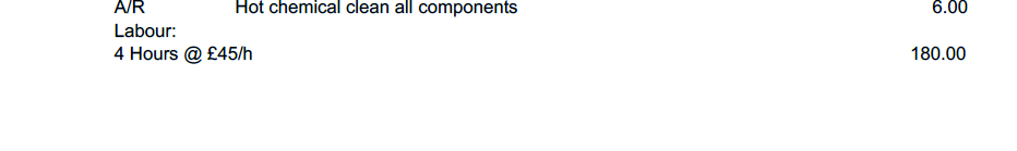

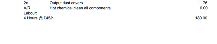

The price for my diff started off at £300 but ended up at £700 as the extra work emerged as they stripped it down
Below should be a screen shot (in 3 or 4 bits the invoice) and not in the right order sorry but you can see the costs

PDJ's invoice is for a BMW LSD wide case diff (type 215), which is not the same as the one in the si (type 188K). And I don't see output bearings there either.
