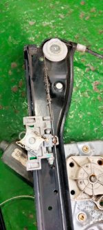

So lastnight I stripped the window reg out and was going to strip it down to do the rebuild and I cam across some frayed wire. Hopping a rebuild will solve the issue but apparently not, someone has already been in and done one before and bonded the cover that usually held together with rivets and now has gone brittle so the cover for the reel just broke apart 🤦🏼‍♂️
