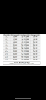

Also you can run anything from a 215-245 tyre but 225-235 is ideal…
