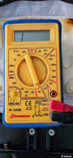

Put your multimeter in this setting:
When it reads 1 that means there is no circuit continuity and the heater element will not work.

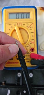

Touch the 2 prongs together and it should read 0:
So now put a prong on one wire and the other prong on the other wire. Doesn't matter which way round. You want a reading of 0 or anything thing below 010.
Any higher than that and there is resistance on the circuit, either a break or close to a break in the element.
