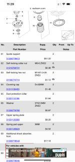

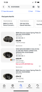

Guys, it looks like I need the top spring plates (the bit below the top mount) as the one I have just taken apart is almost rusted through. I don’t believe this part comes when you buy a new damper strut, and I can’t seem to find it listed at autodoc or any other sites I have looked at. I can find the top mounts, and the top and bottom rubbers but not the plate.
Advice please
Cheers
Al

[ref]thespannerman[/ref], found this on ebay
https://www.ebay.co.uk/itm/174796904987?epid=1709515252&hash=item28b2b51a1b:g:TxIAAOSwcMJgwJ0w&amdata=enc%3AAQAHAAAA4DMNbSihI9epFWLxafk87Y0riCublkndf8RWh31rjwvecea8jfw87bTDbPDrJ8R0%2B4J2trj%2BUkkQpuP8876qbDBWp25meON6UTpiPnTr6Tm8mVspLdsrSUj2dt09LGwxlhovR51PNGvFU6aGmQxWJgff2z4vWI4oH%2FVJ63TeVhLZpDOzRjAyioi%2FX3%2BNNkHApAnddPGc4%2BA7A5fOHFTNa8iGREdjoCHJiv1aLZirmntn1AXuMbxj4I2uGyQAL55CC1%2FRvXPzIdcCO3hnyE%2FvxcBBRONO3EjsnnAt2dhN1KwC%7Ctkp%3ABFBMqNqr18Rg
OK, so Stuart types quicker than me :rofl:
Ok, I think I have now ordered all the bits I need, thanks chaps
The spring breaking has done me a favour as the upper spring plate is in really bad condition, so a full replacement on both sides is well in order :thumbsup:

Just checking.................. you do now about Realoem and how you can use it to get part numbers? It's my default now: grab the Part Number and stick it into an ebay search.
https://www.realoem.com/bmw/enUS/select?product=P&archive=0&series=E85
Start here and populate it with your car details.

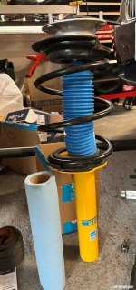

I went Bilstein B6 (some call them Bilstein HD's) suspension all the way around the car. My rear springs were cracked at the start of the tapering they do near the end of the coil. I bought the M sport Lesjofor springs that have no taper near the end. Took months to get the rear shock absorbers since Bilstein is having massive raw material shortage issues once Covid started. I did the job earlier this year in April. I used the lemforder mounts. One thing im not happy with after the job is for some reason the front end sits a tad high. I had the original stock suspension before the job. Car rides the bumps very nice now, used to cringe after every pothole. z4-2.jpgBilstein.jpgIMG_1677.jpgRear Coil.jpgOriginal Rear Coil.jpgBuild.jpg
