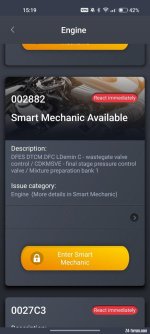

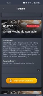

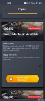

I've just ran a scan on my car with Carly and overall I really like it but sometimes it just throws back absolute nonsense.
I've swapped coils 4 (bad) with 1(good) as it was just saying number 4 was bad but now the new code makes no sense to me. The first screenshot there says cylinder 9!?
Anyone help with these?

Really sorry. I can never work out what Carly is on about. Seems unnecessarily obscure.
I usually put straight into Google:
BMW z4 fault code 27C3
Then have a sift through the hits that come up

Strange
When I put them in Google and do a bit of searching I get a misfire on cylinder 4 and the next two are related to the misfire- the o2 sensors detecting an over fuel?

I swapped the coil pack from cylinder 4 to 1 but then I ran the code reader again and it gave me that nonsense so not sure what's going on.
O2 sensors is something I'll check (when I find out where they are!). In the mean time I've ordered a new boot that comes from the air filter as that has a split in it. Quite a big one I may add so starting there as its very obvious that may cause a running rich error.

So I've had more time to look into this (realise it's been a while, got hammered at work with overtime). I've replaced an air line that I thought might cause the issue as it was badly cracked. It hasn't but was nice to fix that regardless.
The codes do mention lambdo sensors. I refuse to believe it's a misfire though as it's not running rough at all. Starts up perfectly and then idles as it should. Even under load it's fine.
So next course is the sensors. But I have zero experience with these. Where are they, and how do I replace them (ie is it hard or is it a DIY job).
