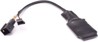

^There are actually four versions of the module, suitable for our E85/86s. Unfortunately, it seems that least some varieties are currently out of stock. Anyway, the four versions are:
- the above connecting to the CD-changer wiring behind the vertical boot carpet;
- the above + mic for taking calls;
- the same module, with a wiring harness to attach directly to your headunit: https://www.amazon.de/gp/product/B0773QRL6K/ref=ppx_yo_dt_b_asin_image_o03_s00?ie=UTF8&psc=1; and
- the one with wiring harness connecting directly to your headunit + mic for taking calls. Apparently also sold out currently.

Hi guys. I was able to remove the necessary carpet in the boot (the horizontal one right behind the CD changer. There is 2 plugs on that adaptor as shown in the initial post. I was able to find the connector for the smallest one. But I was not able to figure out where to plug the big connector. I did not find anything that was looking like it.
The short step by step sheet that was provided with the adaptor says that it should connect directly at the cd changer. But it seems the changer has a wire coming out (no plug). But those doc are generic for many kind of BMW so I guess I could not take that doc for really precise.
Question: Can I only connect the small one? Maybe the big one is for another type of car. Or both need to be plugged?
I have a 2007 M Roadster wit the Navigation package. Any hint?
@Frag: no, you need both of the connectors actually. They are not alternatives, but complimentary. If you do not have a CD changer installed now, the connectors might be a difficult find. Did you already scan the remainder of the vertical wall and did you look into any holes, etc.? If I am not mistaken there are reports on various fora about these connectors being tucked away making them difficult to find.
