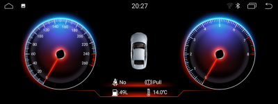

I have installed an android 10.25 Krando PX6 9.0 4+64G which was for BMW Z4 mod 2006 without screen with origin radio and cd player.You must cut dash but that is not very difficult. The screen has good fitment but takes a bit of the view. You get no help from the dealer, but it is easy to connect. There are some parts that does not work. It will not connect to idrive knob. It will not connect to car spesific (like speed, rpm and so)It will not connect to obd dongle. For the rest everything works very well. Navigation, movies, steering wheel knobs,back up camera, music streaming and so. It is possible that I can have done something wrong in the set up but there are nobody to answer such question. I will reckomand another unit. Krando say it is for Z4 E85 without screen. But in the setup meny this car isnot to find
Please please please remember that these screens are design for cars with CAN system, the Z4 E85/86 doesn't have CAN but I & K bus. Thus you lose many functions.
