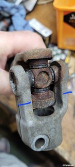

Hi all ...ok so this is how I made my shaft..
Parts I bought are
1. Standard z4 intermediate shaft ( ebay £40)

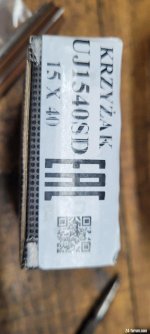

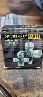

2. 1540 universal joint kit ( Driveshaft parts Ltd £10)
2. 15mm hand reamer ( Amazon £15)
Ok so first I cut the lower splined yoke from my existing shaft on blue marks
Then I cut the correct sized splined yoke from the column end of the ebay shaft on blue marks20230518_085054.jpg
Then pressed out old needle bearings in vice.
Cleaned out stake burrs from bearing holes with reamer
Then fitted new uj with upper splined yoke from ebay shaft on bottom end of my existing shaft
Then I used a centre punch to pin in the needle bearings to stop them moving ...you can get a stake tool but a kit is over £400 and would need a hydraulic press as well.
Hope this heps others out ...saved me buying a Z4m shaft at over £300 :thumbsup:
