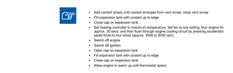

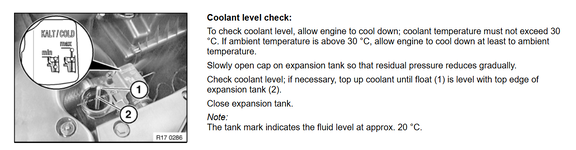

As above, I have the 2lt engine with the non-electric coolant pump.
I'm trying to refill my cooling system.
There is a bleed screw at the top of.the expansion tank, where the floating level indicator is.
But there is also a bleed screw higher then this where a coolant pipe joins the small oil cooler next to the oil filter cap?
This bleed screw is about 4 inches higher then the one on the expansion tank?
If I bleed air from the system from the lower one on the expansion tank, will air be present higher up?
Or if I bleed the system from the higher one, would it not want to over flow into the expansion tank?
