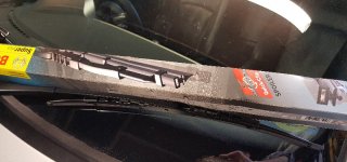

Couldn't improve my judering wipers so decided to scrap my modern aero blades buy a set of old style Bosch blades. Got the Bosch Super Plus SP21/19AS set, which includes a 21" drivers side with spoiler and a 19" passenger side, but this blade is curved.
Which side should the spoiler go?
I assume it should go below the blade and not at the top as per my photo. I'm not sure if the mounting unclips to turn it around.
The passenger side blade is curved. I put the box above to highlight the curved blade as without it wasn't easy to see. What's the point of a curved blade? Is this curving the correct way or do I need to change this over too?
