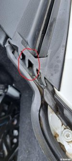

I have taken some photos.
First one I have put a red ring around a drain hole.

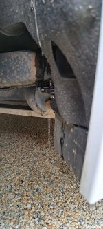

Second shows where the water comes out. In front of the rear tyre

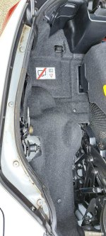

Third one shows the gulley to the rear lights
There are 2 drain routes at the top of the A post
I hope this helps other people.
