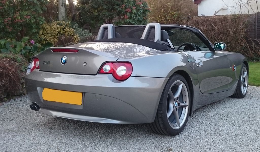

Added a pic too, had it since 2009 and dont think I've added any since . :thumbsup:
