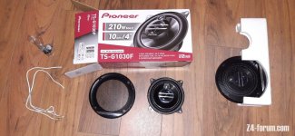

My Z came with 2 speakers missing :thumbsdown: Fancy building a car and skimping on 2 door speakers! Anyway l've moved on.
I want to install these 2 door speakers. Are the wires already in place in the door ready (Wishful thinking) or do I have to hack into the existing circuit to wire them in?
I've checked the video link from a thread on the forum but it's an 'upgrade' vid. A simple unplug replace and play. If it's necessary to hack into the circuit I'm gonna need some step by step guidance. I have my tools ready, a knife, fork, screwdriver, hammer and a large adjustable spanner :D

When you have the basic audio (i.e. nobody messed around with it before you did) then there is NO wiring present in the door. Tweeter gets a fullrange signal so you can split that wire.
Personally i chopped the plastic trim to fit the "missing" speaker, but i went with a focal 3 way system with a 3" mid speaker, so slightly smaller then the required 4"

Sounds like a good setup. Thanks for the reply. I'm just going to go with the BMW oem speaker, £50 or thereabouts. The sound quality is plenty good enough. It just needs that full range in the door to bring it to life.
At the risk of furrowed brows from the purists and audio-philes, I fitted a pair of these cheap but decent speakers into my empty door grills.
https://www.amazon.co.uk/dp/B0756WW942/ref=cm_sw_r_cp_apa_glc_fabc_49YB56S6HT1X2NB0SKX3?_encoding=UTF8&psc=1
I put some roofing flashband in the doors and door cards. For a total outlay of £27.50, the radio sounds much better, the doors quieter and more solid sounding.

You'll need either some crimp connectors or some bmw connection adaptors if you are removing the feed from the tweeter, just helped fit a set of crunch dsx42 in a local members doors, pretty straightforward job👍

I did use scotchlocks to connect into the tweeter wires, but I thought it would be better to use some of these Y-splitters, so I have ordered some and I'll retrofit them.
https://a.aliexpress.com/_mMRu5gX
The reason I came to this conclusion is that it takes a lot of force to pull the door card off and it is not always possible to control just how far it is going to spring off, so there is danger of it snapping the speaker wires if they cannot be fully disconnected beforehand. Hence the Y-splitters will be placed up by the tweeter to unclip before the door panel is removed.
Sounds complicated, but you'll understand why once you've had a look at the door card removal.
I fitted the door speakers last weekend, i purchased 2nd hand BMW Speakers from ebay with the same specification as those fitted behind the seats on the standard 6 speaker system. BMW Reference part number reference - 65136950131
I then purchsed the bmw speaker wire harness splitters from ebay to save splicing into the car speaker wires:
https://www.ebay.co.uk/itm/BMW-Speaker-Stereo-Plug-Connector-Adaptor-Wiring-Cable-Y-Harness-Splitter-2-Pol/192521420970?ssPageName=STRK%3AMEBIDX%3AIT&_trksid=p2060353.m1438.l2649
I also used something similar to this along with a short section of speaker wire to make wiring looms that effectivaly made the speakers plug and play, and prepared them ahead of the install:
https://www.ebay.co.uk/itm/BMW-1-3-5-series-e90-e91-e92-e93-e60-e61-mid-range-Speaker-Wiring-Plug-Connector/392805299236?ssPageName=STRK%3AMEBIDX%3AIT&_trksid=p2060353.m1438.l2649
I managed to get them much cheaper than advertised but the seller has since left ebay.
Great video on door card removal on youtube... If i hadnt added sound deadening to the doors could have all been completed in 45mins and im not mechanically minded!
