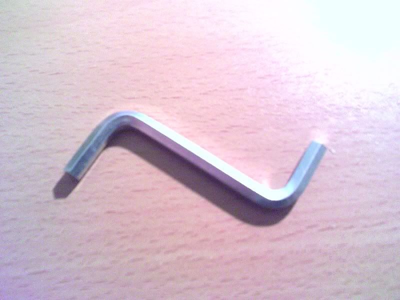

There are 8 chips in total, 3 on the top, 1 on each side, and 3 at the bottom. I opend the bonnet and removed the 4 bolts on the front air duct, and removed it from the air filter box. It was quite hard to detach the air duct from the air filter box. Then I could put my arm through the gap between the bumper and radiator to get access to the back of the grill (do not attempt if you have large forearms). It was then easy to press the clip with the finger tip and remove 6 clips (3 on top, 2 on sides, and 1 at the bottom near far side). The remaining 2 clips were difficult to remove with finger, as there was a horizontal bar right behind the grill. The gap was very small. I worked so hard to get my finger through to get the 2 clips released on the right grill, but not the left one. So I used this
to remove the remaing 2 clips on the left grill.
