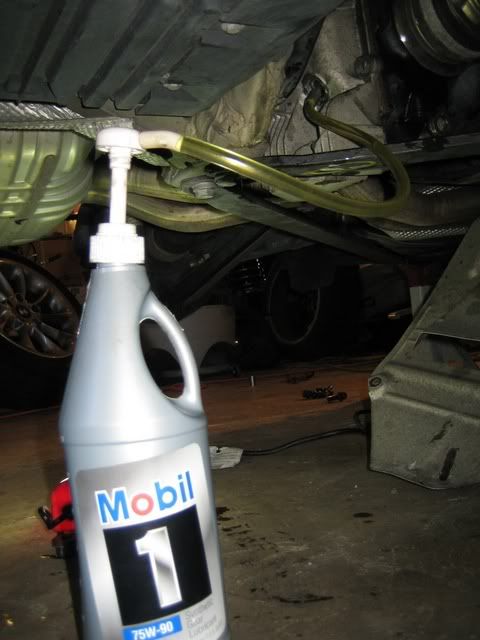

4)1 quart of 75w-90 oil of your choice...mine being Mobile 1
5)Hand Pump

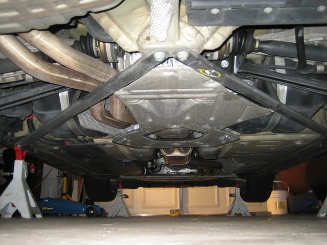

My way of jacking up all four tires safely.
1)jack driver side only, put the jackstand under the lower control arm.
2)do the same on the passengerside
3)go to the rear, look at the center where the two bars come together and bolts on. Jack from there to a position and place jackstands under the factory jack location on the sides
1)get the car in the air. all 4 tires off, and in somewhat of a leveled position.
2)notice where you jacked up the car in the rear? well there is the silver covering, you need to remove the rear half of it by using 8mm socket wrench

5)using the hand pump, pump diff oil in until it oozes out of the fill hole
