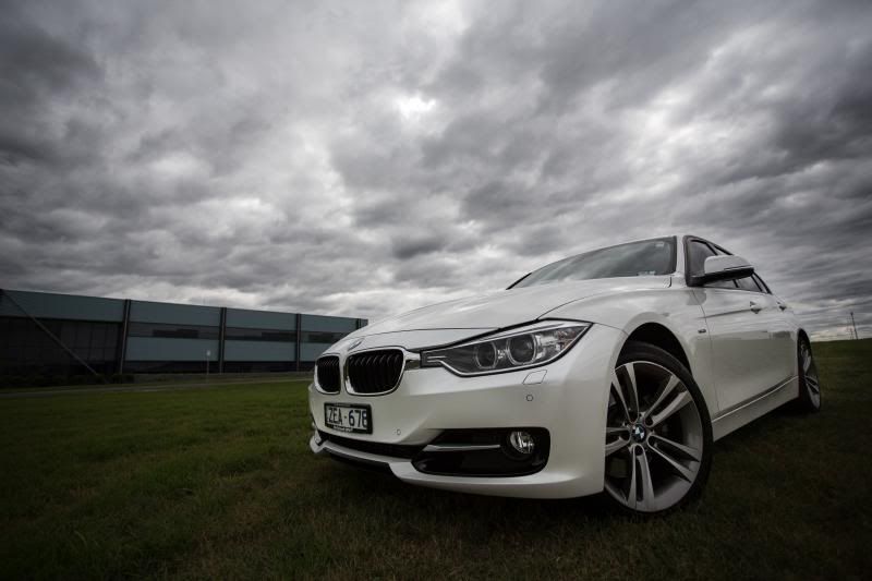

Looks good despite the cloudiness of the sky!

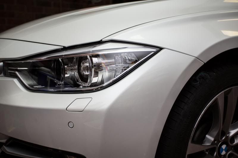

My previous experiences has been with Zaino on a Sapphire black z4. From the result on the zaino, i was very happy with the deep colour in the dark and the metallic paint sparkle in the light. The swirls were removed well with the zaino and the wax had really good life on the car
This is the first white car i have detailed. I am not sure if it is just me but the metallic in the paint did not pop! I made sure i did everything right and checked constantly in between polishes. If someone has been able to make white metallic paint sparkle, please let me know. Other then that, Dodo Juice Prime Lime removed most of the light swirls but left the bigger swirls on the car (even after 2 good coats of polish). The Zaino on the other hand took out some big swirls that really impressed me. Applying the Dodo Juice Supernatural was also i difficult task on a white car (im guessing for most waxes) as i could not see what i was doing. However, the wax does look great with great beading in the rain (had to drive in the rain the next day!!!).
Overall, not a bad product but i will be trying other products for future detailing adventures to try to achieve the shine i want
