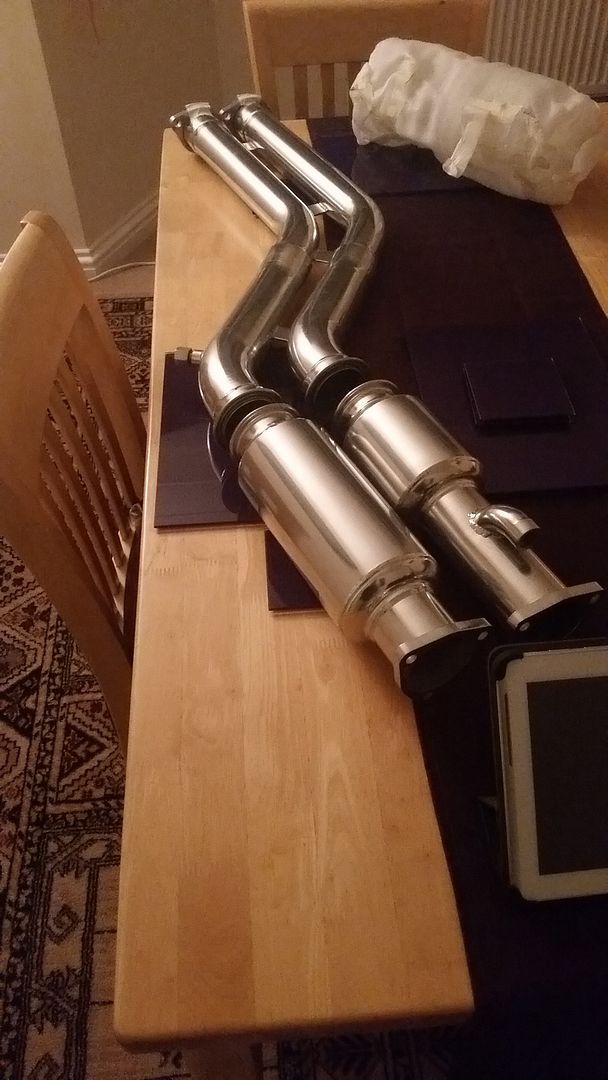

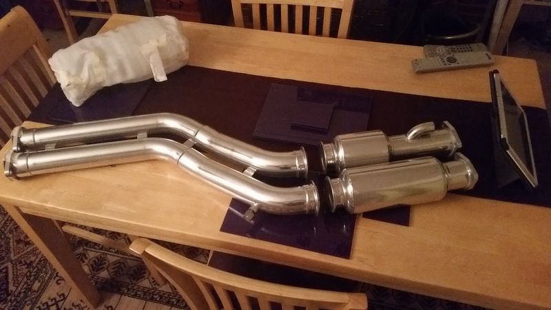

i run large bore section 1 ceramic coated, V band system with interchangeable 100 cell race cat or Decat resonator sections, Stock x pipe ( wanted to keep the little resonator, tried others stock seems like a nice piece, RPI GT race mufflers with Removable bolt in silencers , ESS S/C tune is already CATless ready as long as the Rear O2s are in place and functional so no light, on a stock car this would give a CEL in both instances.

V nice!!
Big bucks?
no not at all got them from the usa DKF racing who has no ceased trading, they WERE big bucks but they had lots of issues with them causing a CEL luckily this wasn't an issue for my car and managed to bag a total bargain from one of the owners who didn't want the crap of dealing with some of the issues that sadly came with the setup.... His loss was very much my gain :thumbsup: :thumbsup:
