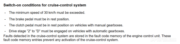

Bit baffled, all was working fine, went to use it this morning and nothing. Only thing id done is clean it last weekend so wondering if I've knocked or pressed anything. Would it flag up a code on the code reader? I've got a Creator code reader, so going to check that later today.

Looks like my brake light is staying on so could be the brake sensor problemo.
Ah that makes sense. It thinks the brake pedal is not in the rest position. Hopefully just a dodgy switch.
