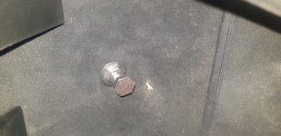

Make your own from a bolt, washer & nut.
Adjust the height when the clutch is warm, I have mine positioned a bit below the clutch engagement point. It did not improve shifts for me, that was achieved with Vibra Technics engine mounts, removal of CDV & a ZHP.
