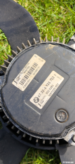

My E86 N52 has this fan: 17427519704 - which is unique to the Z4, and therefore expensive.

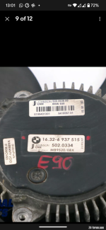

I didn't want to spend £80+ for a second hand fan, so instead got one from an E90 instead for £25. It worked just fine! The parts numbers were different, but there was one non-BMW number that was consistent between both fans which gave me the confidence to try.

Photo of the E90 fan part numbers:
E86 fan part numbers:
I fitted it, tested it with INPA, and it span up to the 15%, 50% and 90% set points without any issues, so seems the control logic is the same too.

E90 eBay listing: https://www.ebay.co.uk/itm/262814658490
E90 BMW part number: 17117590699, 16326937515
(Part Replaces: 17427523259)
