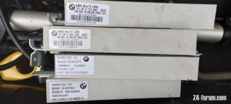

Sounds like a GM5 module fault is the cause if your central locking problems. You need to see what type of GM5 module is fitted to your car, fairly easy to get to it once you take the glovebox out. Its a long oblong plastic case with two multi pin connectors plugged into it. You can take it out to have a good look at it, these modules are plug and play so no immediate coding is required. You could get a replacement from one of our resident Breakers on here once you know the type you need. An alternative is to send yours away to Merv in Harrogate who repairs them.

Photo showing module types
