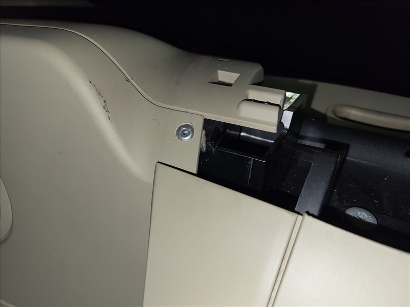

Is it normal to have rivets on the top of the center console like this:
91060
It does not like factory to me as the right side is of by a few milimeters compared to the left side
