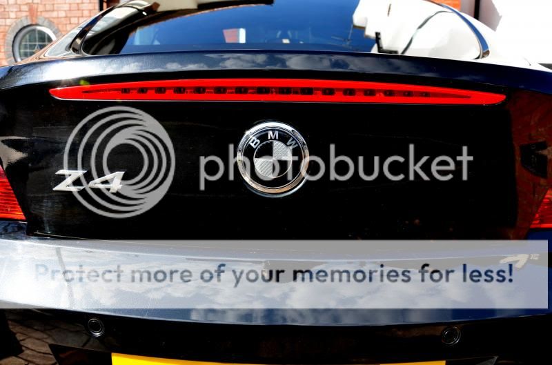

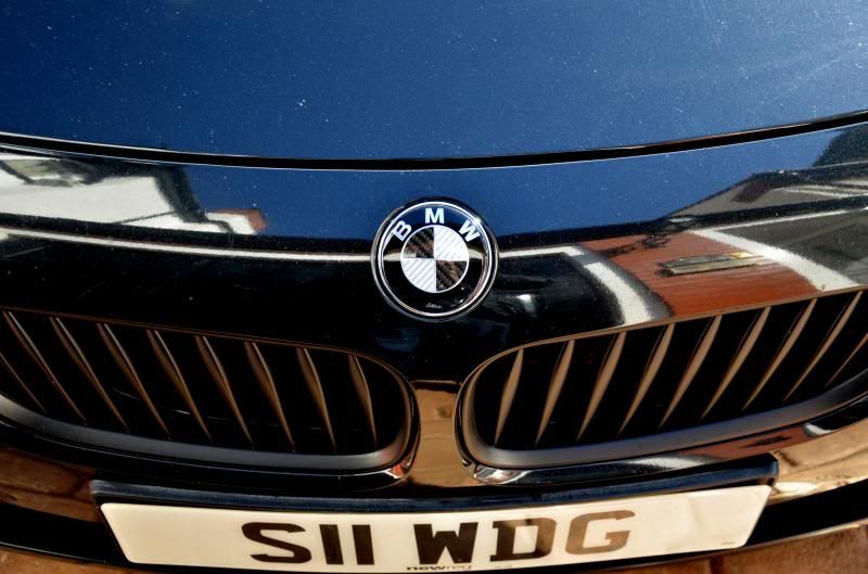

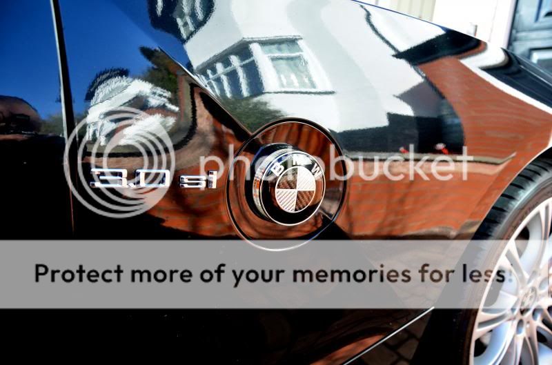

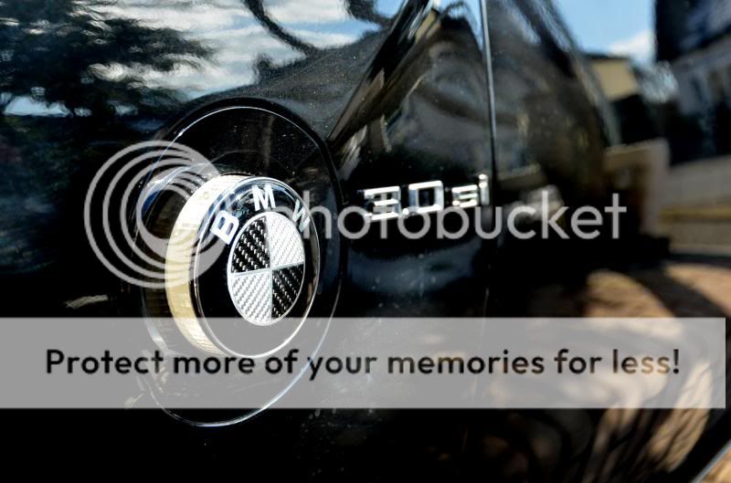

Got the badges on today, pretty pleased with how they look! :D
Went for the ebay option, around £50 all in.

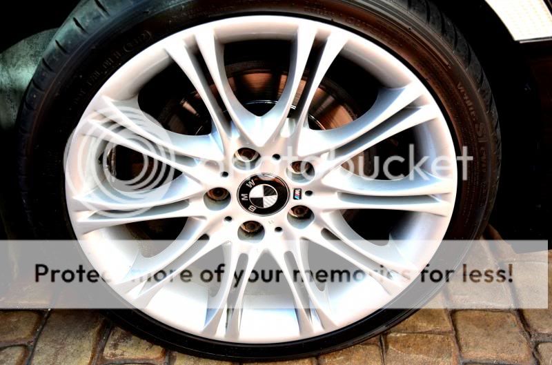

Just emailed Ian to get a price for new wheel caps - mine are a bit mucky now, and a total PITA to switch to my summer wheels because of having to use silicone adhesive to keep them in place. Hopefully he has a set of new style OEM fitting ones for a decent price.

The wheel badges were from another seller, not real carbon though:

To remove the OEM badges, i used a Stanley blade, be very careful though, mask the are off if possible! Gently cut around half of the badge and prize them off. The front badge is secured down with 2 self tapping nuts easy to access if the grills are off.
All of the badges required modding. The front one is 73mm and OEM is 70mm so a bit of dremmeling around the bottom edges did the trick.
The indicators and rear badges have a 2 nipples on the body which were dremmeled down a little and the carbon badges also had plastic nipples on which required snapping off.
All three badges were secured down with adhesive mirror fixing pads, cut down to size and a blob of silicone sealant in the centre, all seem very secure now.
Hope this helps, pretty involving but great results once finished!
