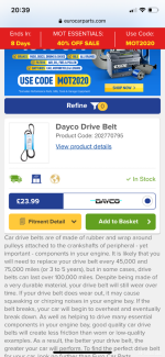

There’s this at Euros. Dayco are an ok make. However if you live in Surrey I can get you one at cost and you can pop over and pick it up mate

Sorry if im being rather silly ahaha but what is a fan belt then? Is it a drive belt. Ac belt. Whats going with it have a look here.
Alternator/Waterpump drive belt here https://www.realoem.com/bmw/enUS/showparts?id=BT33-USA-06-2004-E85-BMW-Z4_25i&diagId=11_3416
Air Con Drive Belt here https://www.realoem.com/bmw/enUS/showparts?id=BT33-USA-06-2004-E85-BMW-Z4_25i&diagId=11_2263
Nah i ment if he's saying get a fan belt. What belt does he mean. Since im reading fan belt can also mean alternator belt i think but just wondering if they are the same why the prices are different confused.

On early cars, pre mid '80s(ish) the fan belt used to drive the radiator cooling fan. Then came a viscous coupled fans also on the "fan belt" loop. Nowadays the radiator fans are electrically driven as and when needed so the term "fan belt" is just an old school name. The pre-facelift Zed has 2 belts, one of which drives the alternator & water pump, the other does the aircon pump.
Best get is to get a secondhand or refurbished alternator. If yours has seized then the alternator belt will need replacing :thumbsup:.
